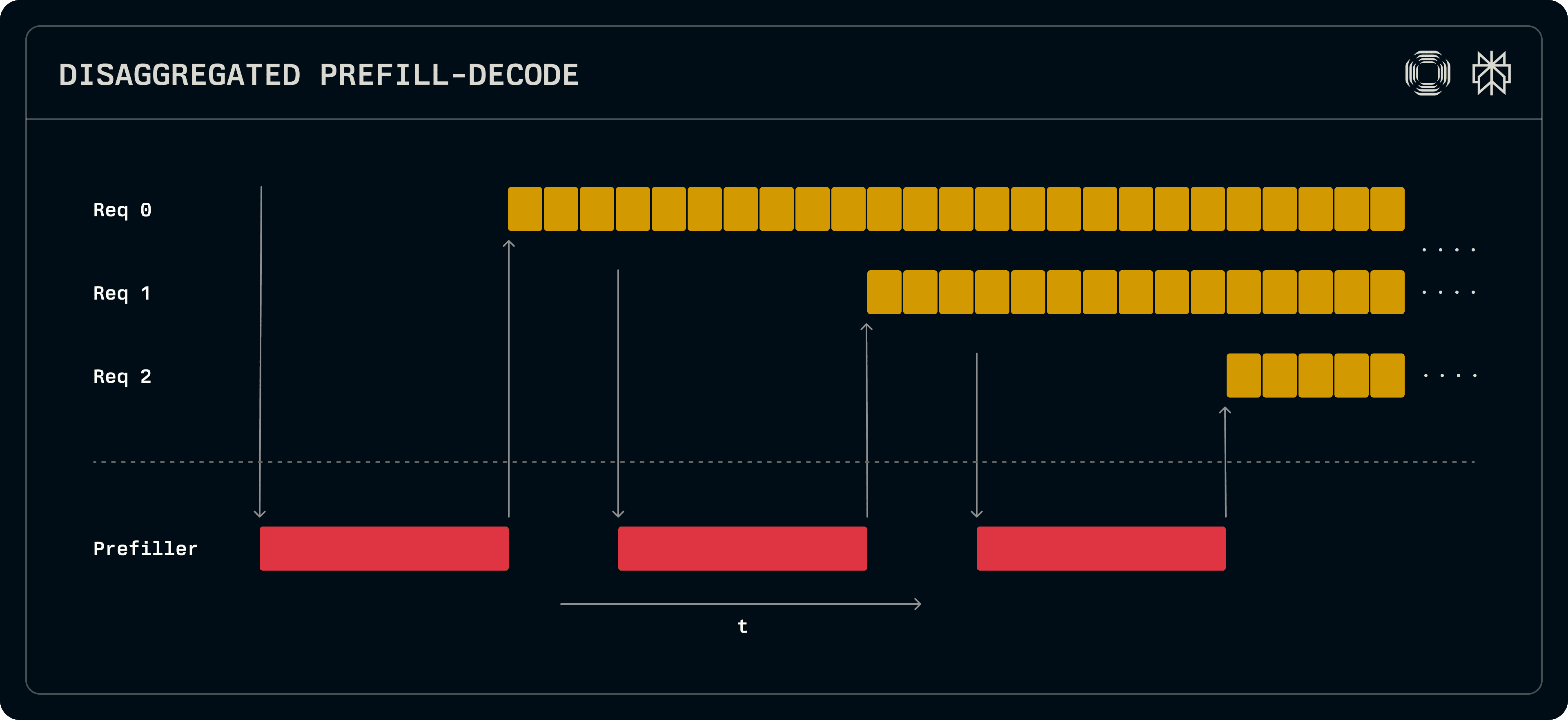

When mixed together, batches containing requests for prefill incur higher latencies through the forward pass, negatively affecting the decode throughput of the entire instance. While mixing prefill requests with decode requests or employing chunked prefill can slightly improve decode performance, it is difficult to maintain sufficient prefill throughput to process enough requests on an instance to maximize decode throughput. In the case of large models, with typical output lengths, to maintain a large batch size for decode, prefill must be performed often enough that it significantly degrades average latency and causes stutter in the output.
These issues can be addressed by using a separate set of nodes to perform prefill and decode. By associating a prefiller node with multiple decoder nodes, sufficient requests can be scheduled for prefill to maximize throughput and maintain a large enough number of concurrent requests on the decoder nodes to also maximize decode throughput. The prefiller nodes populate the KV caches, which are then transferred to the decoder nodes. Since the decoders no longer have to break for prefill, latencies become much more deterministic, as the overall impact of growing kv_len of active requests is much less pronounced. The cost is paid in an increase in Time to First Token (TTFT), as the transfer of KV caches over the network can take tens to hundreds of milliseconds.

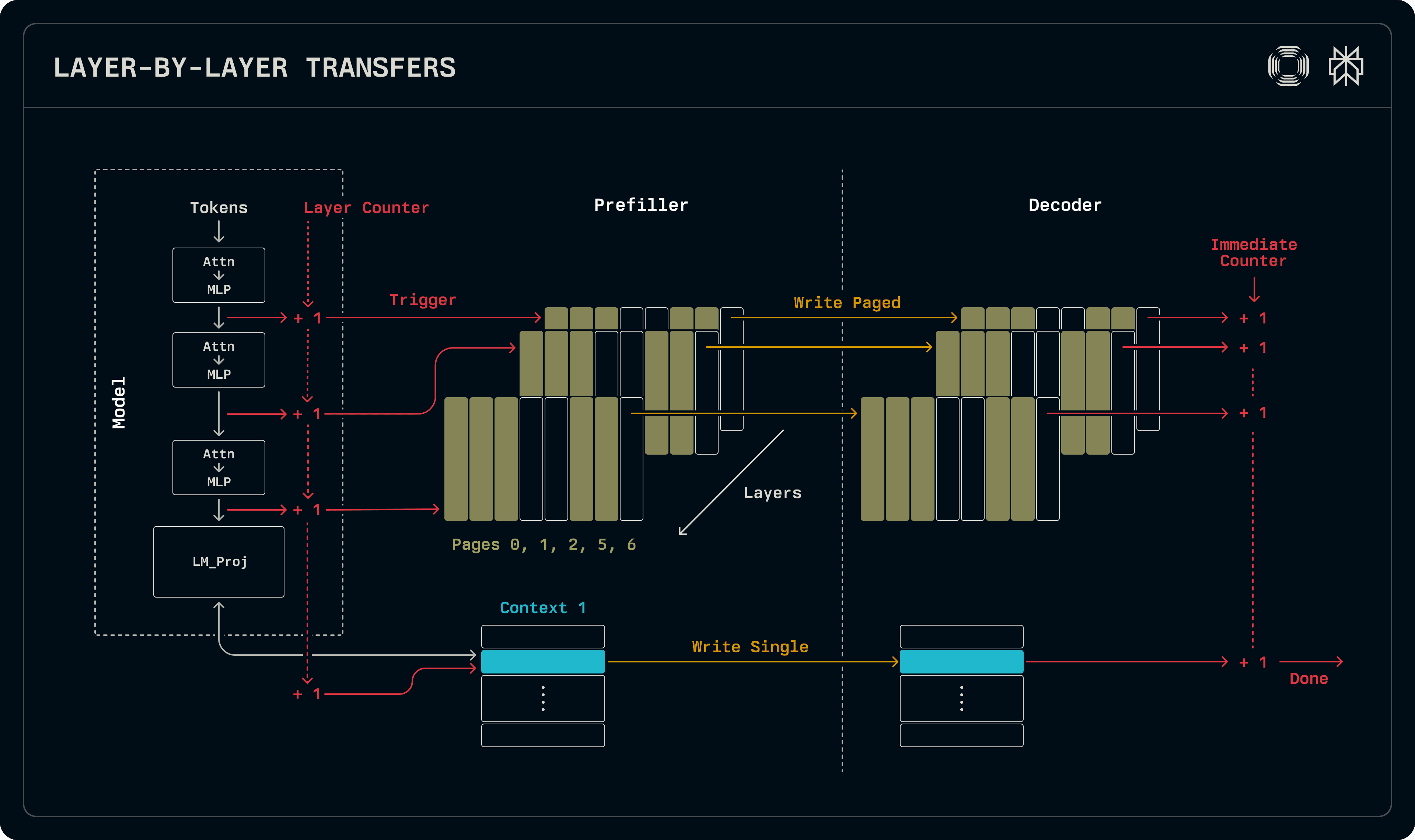

Upon receipt, the prefiller node allocates a corresponding set of source KV pages and schedules the request for prefill using its local engine. To minimize latency, transfers do not wait for the forward pass: instead, KV page copies are initiated as soon as the model finishes appending KV cache entries to the KV cache for individual layers. Since prefill requests can be chunked, the batch scheduler notifies the KV messenger of the currently scheduled chunks before execution. To support CUDA graphs whilst being able to track layers, the messenger keeps a dedicated thread polling a counter incremented after the output projection of attention. The counter is maintained only on the lead node in a sharded environment: even though the KV cache entries are valid after append and before attention, the output projection is reduced across ranks, implicitly synchronizing them. Once a change in the counter is observed, the messenger is notified and it calls fabric-lib to initiate the transfer of a layer.
After the transfer of the last chunk is complete, any additional metadata is also copied over: speculative decoding or MTP require logits and hidden states to be moved to the decoder. These copies are also performed through RDMA, to and from pre-allocated buffers.
Upon the completion of all pending transfers of the last chunk, the prefiller node de-allocates the KV pages and completes the request. The decoder node is not explicitly notified: instead, it uses immediate counters to keep track of the number of operations completed. The number of RDMA operations on the prefiller side is proportional to the number of pages transferred. Upon the completion of the known number of page and context copies, fabric-lib calls the KV messenger to indicate that a request is ready for decoding. The messenger de-allocates any context and hands the request over to the LLM engine.

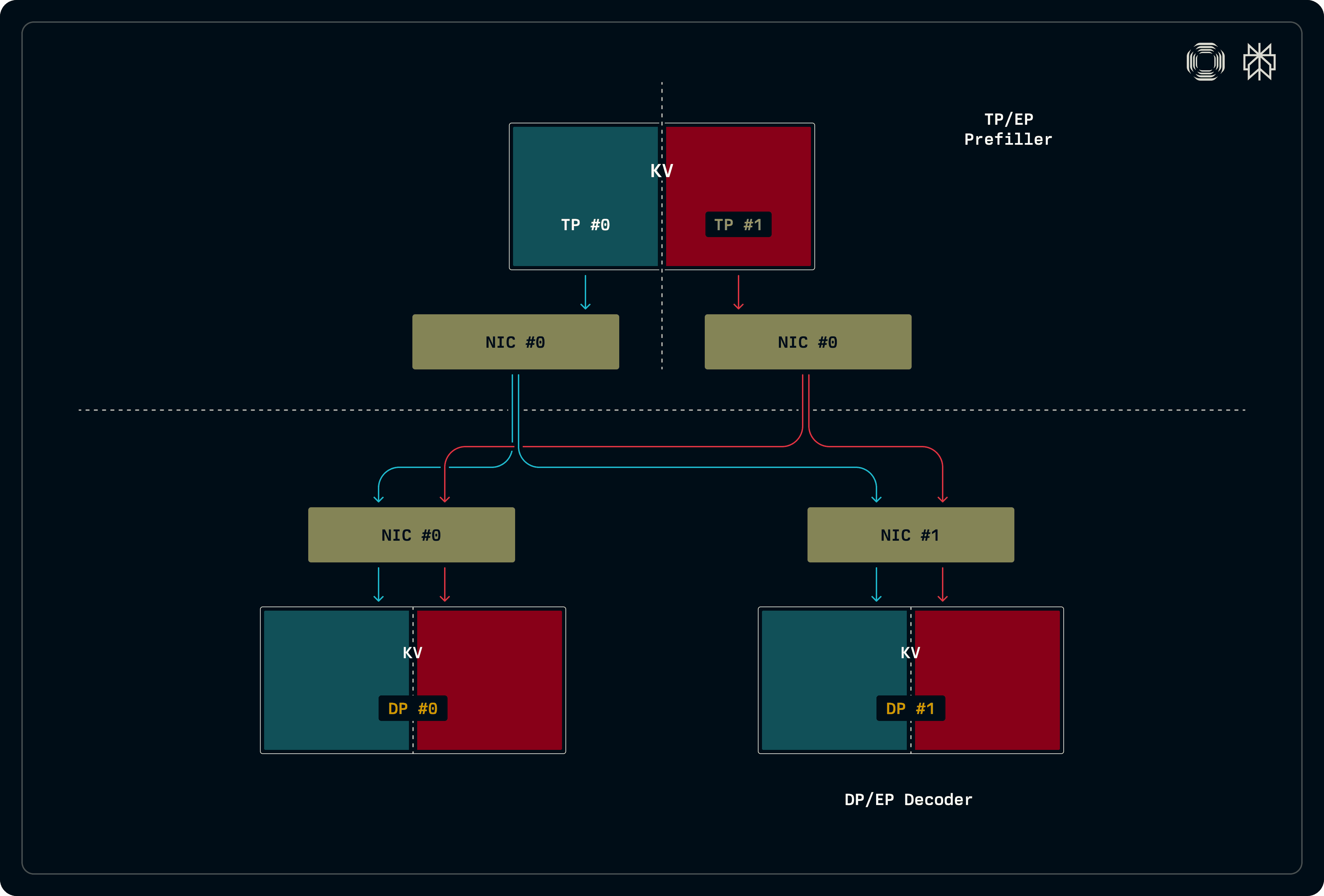

If the prefiller and decoder rely on Tensor Parallelism (TP) and shard or replicate the KV caches identically, a single transfer engine coordinates multiple devices to send and receive the pages of all the replicas. In order to be able to use a single messenger and transfer engine despite the fact that the executor of the model is replicated across multiple devices and processes, cuMem and cuMemImportFromShareableHandle are used to allocate the device memory backing the KV caches and to map it into the main process. The transfer engine inspects the node’s topology to find the NICs and the CPUs in the closest NUMA node to use for the transfers of each of the KV cache slices.
If the source and destination shard identically, transfers are trivial as there is a one-to-one mapping from the devices and pages of the source and destination. In this situation, sharding implicitly helps transfer latencies: by using more GPUs, more associated NICs can be employed, reaching closer to full bandwidth utilization. However, if there is a mismatch, the transfer engine must split or reconstruct pages depending on the ratio between source and destination slices.
If the prefiller splits the KV cache across more devices, full pages are reconstructed on the decoder by sending the corresponding halves out from the prefiller devices. If the decoder has more shards, it receives pages from multiple sources. The decoder needs to know of the sharding scheme of the prefiller in order to be able to compute the number of RDMA writes it is expected to receive. If replication is involved, the prefiller groups the devices into replica sets that replicate the full KV cache within themselves. Destination replica sets are randomly assigned one of the source sets in order to use all the available devices to initiate RDMA writes.

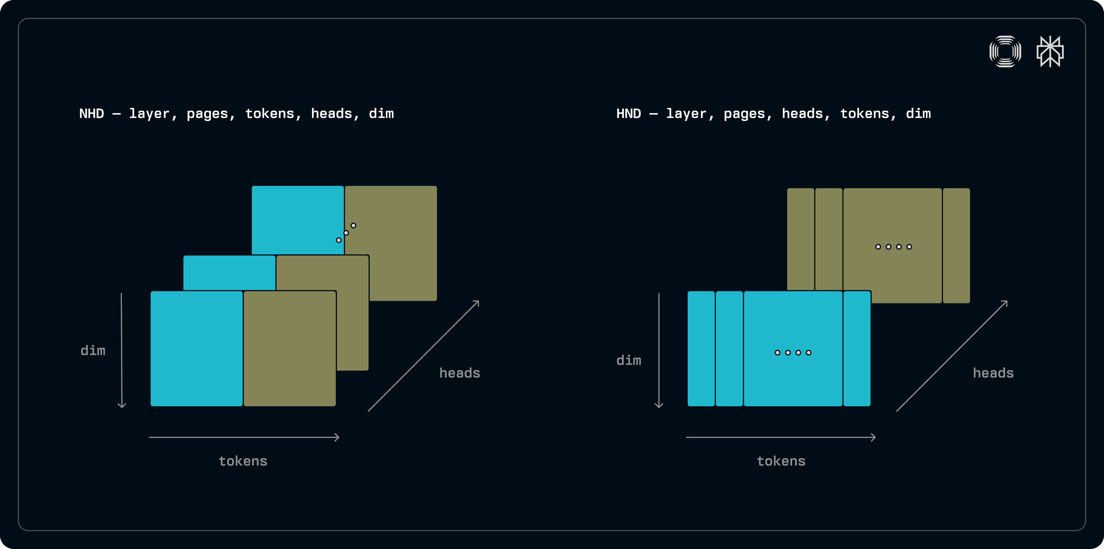

Sharded transfers require a slight tweak to KV caches. By default, FlashInfer relies on the NHD layout, which orders the tokens within a page within the heads. Since caches are most likely sharded along the number of attention heads, this creates discontinuity within the head. RDMA transfers do not implicitly support strided writes, requiring one operation per head to perform the transfer. Instead, in order to reduce the number of interactions with libfabric , we organize KV caches using the HND layout which places the head dimension before the number of tokens. This ensures continuity, allowing a page to be copied over with a single write.
